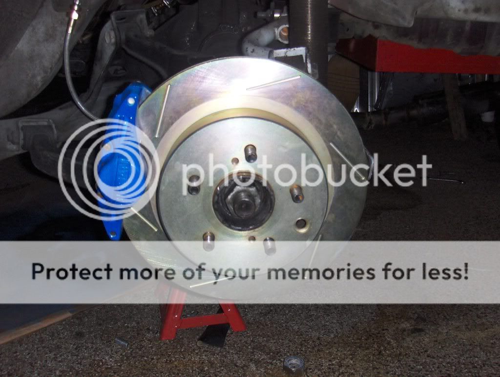

The rotor will slip on no problem, you might have to have a bracket made to align the caliper properly over the rotor though.
As cheap as Evo Brembos are getting, why not pick up a set of those - a guy on Zilvia sells the adapter brackets as well. The stock evo brake line does bolt up to our hardline on the body.

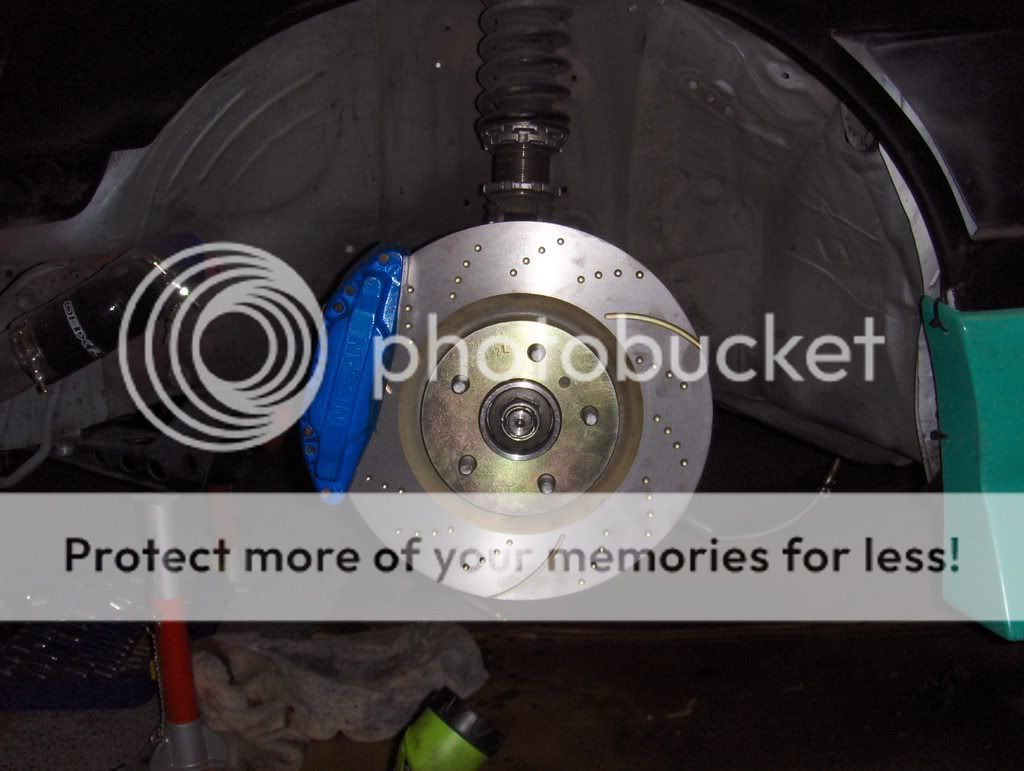

Well u don't need the hubs. Im rocking 350z track rotors 13inch with 300zx calipers. Just needed an adapter bracket for the caliper to work with the large rotor.
U can also do the 350z caliper with 350z rotor it bolts on just need a spacer. Nico club and zilvia have write ups on this stuff. Google search next time its been cover before. Also I hope ur talking about the 350z brembo brakes!!!
