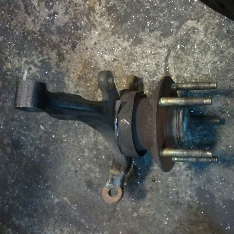

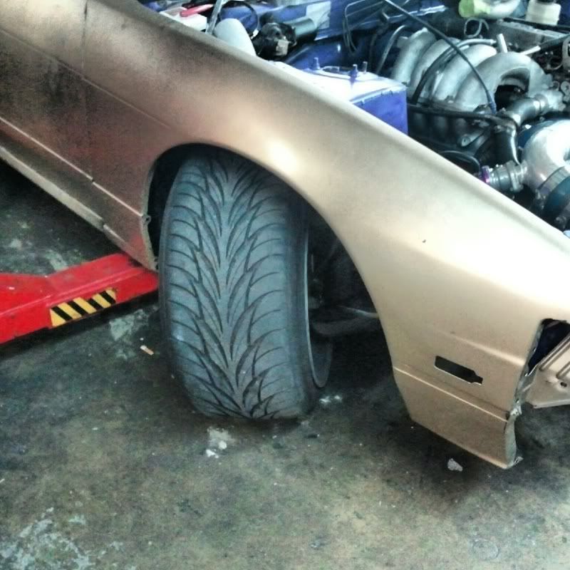

So I'm tired of stock steering angle. I'm always full lock when I slide and i need more steering angle for several reasons.
I'm looking at the PBM kit and I know I'm gonna get it, but while I'm saving up money for it is it worth it to have Harry from Ter-Tech cut and mod my OEM knuckles? I know it will give me the same effect I'm just a little hesistant as to if the moded knuckle may fail at an event at the weld point. I'm not saying Harry doesnt do a great job cuz I know he does cuz I know several ppl who have had him do it. So how reliable is it? And how much did he charge?
Also what other parts do I need to get(tie rods etc...) to make the moded knuckle work right so I can get more angle.
Any info or tips are more than welcome. Thanks:bigthumbu
Unless you want to go crazy low I wouldn't waste the money on pbm. The only thing better about theirs over Harri is the roll center correction. They are just cut and welded like Harri so just as likely to break (unless you are going to wait for their forged single piece ones to come out).
Other mods are going to depend on a few things I would get tie rod spacers at least. It is advised to get stronger tie rods since yet will be threaded out further so easier to break or bend. But you don't need them. also extended lower control arms complement nicely so you an run more camber to balance the positive camber gains at that kind of steering angle. Also you might have a problem with over centering depending on other factors with your car. If you do you can get offset tie rod spacers,eccentric rack bushings or mod the crossmember to move the rack forward but again none of this is needed just helps.
If I were on a budget I would go Harri knuckles, tien inners (or Pbms new ones) spl ends (roll center correction) and pbm spacers.
I have harri's knuckles and i love them. Ive only had them since curacao and but no sign of problems i know of a few other people who has had them for longer and no problem has well. honestly i woulndt. waste my money on pbm.btw i have meagan inner and outter tierods but i just bought the new pbm inner tierods for $80. i would def spend the money and get some decent inners and outters
I run MA motorsports awesometron 5000 spindles. My wheels turn like really really far. All that drift works and pbm and whatever else crap, is crap. Majority of people are goin back to traditional style modded knuckles, cause all that fancy crap, was just a gimmick.
