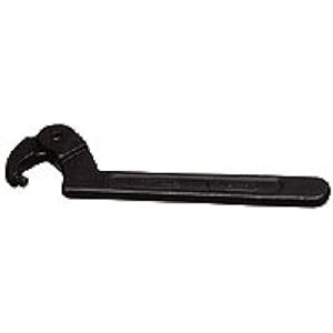

D. Davaine Spectator Jun 20, 2010 #4 u might be able to get it with a pipe wrench but the correct tool is a pin spanner wrench like this
Wolf Haley Grip & Sip Driver Jun 22, 2010 #6 from the looks of that picture u posted........ i can tell u that the part is one piece the replacement comes back jus like that its as green machine said previously
