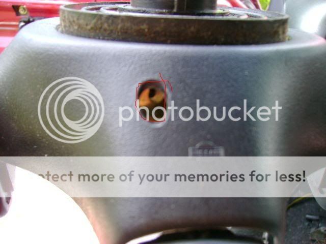

ok well than here it goes. ok here what you want to pull the cover towards you it will kinda pop off some.

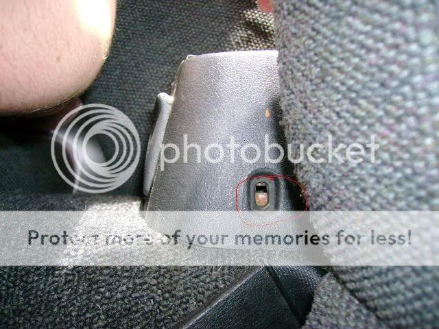

here is the screw that you have to take off from underneath the wheel to take the cover
off( i do belive that this is only on the SOHC cars but i could be wrong)

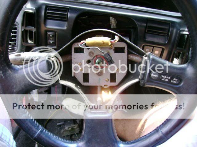

this is the bolt that holds the wheel to the colum. i belive that it was a 14mm
now take these screws off they hold the hold latch on. then you can push it here if you want to or wait till another step.

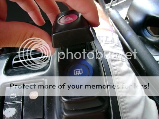

ok pull all the switches out just like this. its not easy but they do pull out and once pulled out un plug them. for the dash light and the cruise control one's you may have to wait for those to take them off they are a little bit of a pain. i would wait till once the plastic trim is lose to then reach behind and unplug.

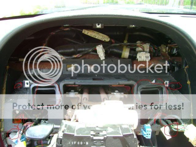

here you can see where the plastic trim is attached to. and once these are out you must pull the bottom part first down then out and then once you do this the top will come off easy. this is the part where now you can do a reach around for the switches back sides haha.

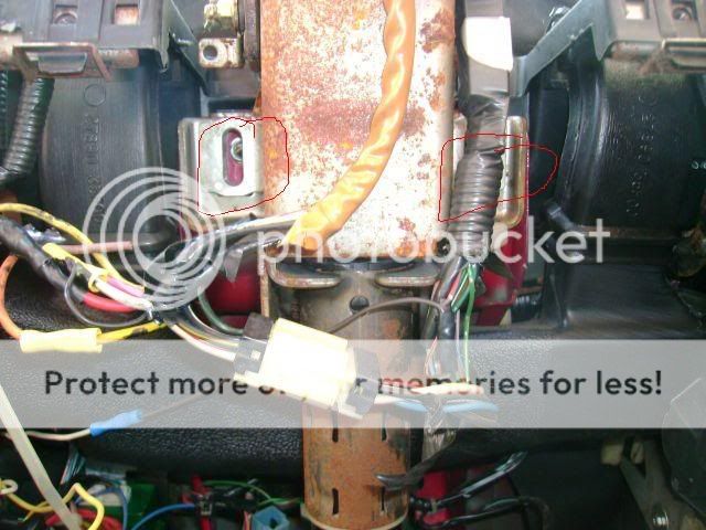

here are the holes where the bolts are for the colum to drop. dont worry the colum wont fall far unfortunatly. ok here is the other pic that i missed cause its to hard to take it and take off the plastic trim that the switches hold on to. push the column down hard and slip that plastic trim off CAREFULLY its not easy trust me just play with it slowly to take it out.

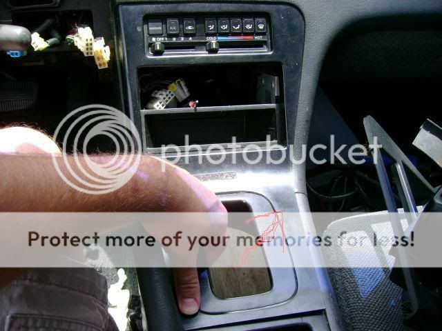

unscrew radio bin A/C controler. and push a/c back in to the dash it will be fine there.

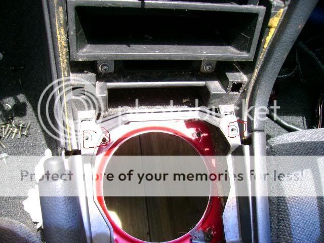

then unscrew these 2 screws

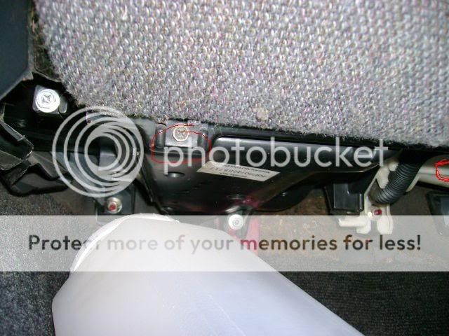

and these 2 screws(one on each side drivers/pass) they hold the center consul down

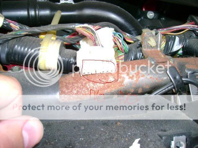

pull up the e brake then pull this up. then unplug these bad boys. CAREFULL with the lighter you may push it out and f it up!

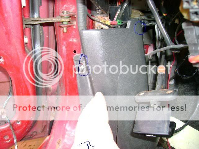

take these off on both sides once unscrewd they slide towards the dash from under the door sills.

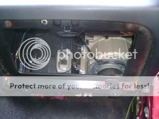

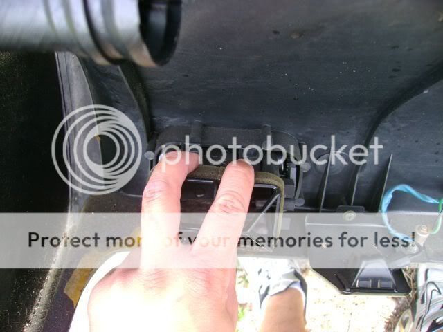

this is the glove box, take the 2 screws out from under it. then open it up and it will fall out if not then just put it on its side and it will come out then.

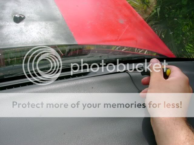

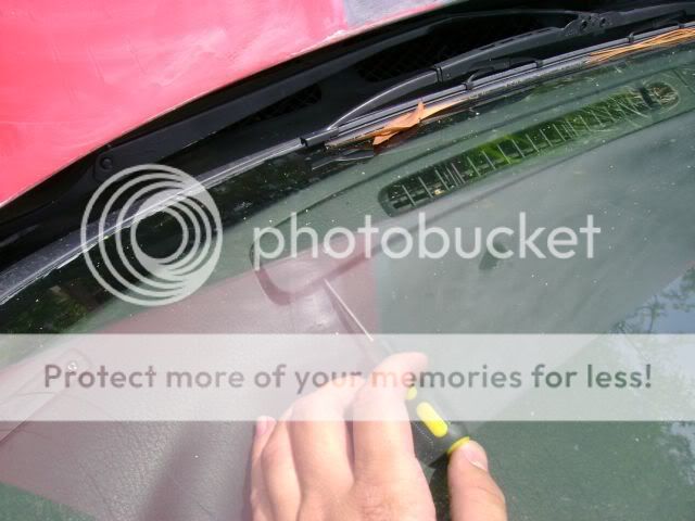

ok here is the the next HARD PART. you must MUST be very carefull here. these are normally very fragile and may still break even if you are carefull. sorry to tell you but i mean you may have an almost 15yr old car this stuff happens. with the pick that i tell you to buy cause it will make your life a hell of a lot easier. carefully put it under and pry up slowly do this across the vents. just look at the pics this isnt easy to explain.
also so you know the pass side comes off first then the drivers side. they lay one over another.
here is an idea of where the tabs are that keep it in place

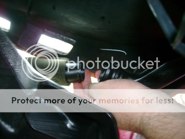

back to the glove box area. look in there you will see this plug for the light in the glove box unplug it. and take it off the metal braket holding it.

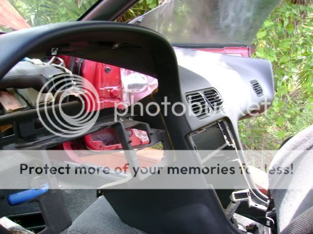

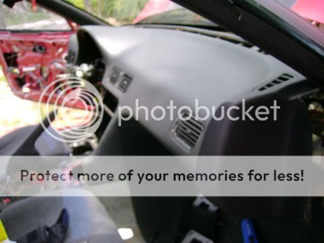

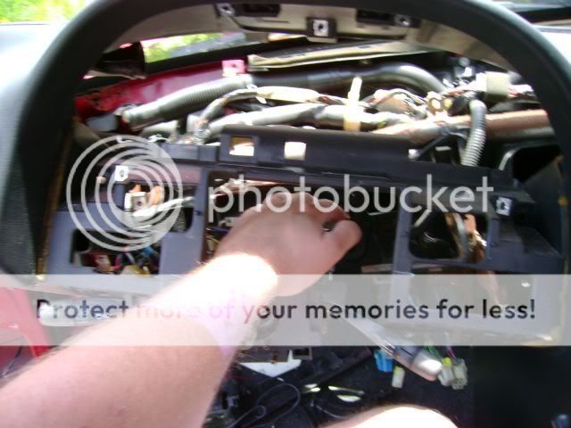

again push hard down on the column and pull the dash out slowly. you have to pull it from each side in the beginning to get it out. also the ebrake may be in the way make sure that it is down. it should make things easier.
out the pass side cause when your siting in the drivers seat its pain out your way and the column makes it a bit harder to pull out.

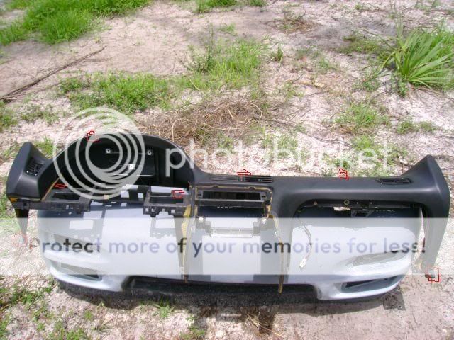

the after math
this should be all the holes for the screws.
if you have broken vents or wish to be a ricer and paint your vents push these tabs down on both the bottom and top and they pull foward
the after math
