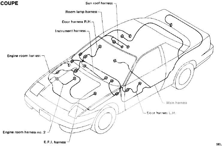

just like the title says, how many harnesses are in a complete 240? like with nothing uncut or shit missing or fucked with.

I believe it's 4; body harness, dash harness, lower harness, upper [engine] harness. Make sure you get the right ones if starting from scratch [i.e. coupe body harness ≠ hatch harness, etc]
Get the FSM if you're really not too savvy on the car..

up to 10
engine room 1
engine room 2
instrument
door rh
door lh
dome lamp/sunroof
efi
main
rear wiper
hatch
s14
chassis main - engine fuse box to drivers side kick panel
chassis sub - under dashboard
interior main - drivers kick panel to drivers side trunk next to seat
interior sub - drivers side trunk next to seat
engine main - ecu to chassis sub to engine
tranny main - engine bay fuse box to starter etc
those are the main ones
