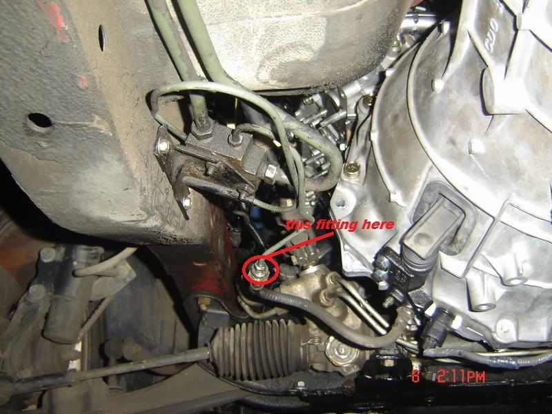

ok so i went about removing it. With laptop right next to me going along with a write up. I got the hardline going up to the master cylinder off easy. I go to take off the hardline going to the rubber line going to the slave cylinder and i notice its fucking stripped real bad i mean rounded. Thats what i get for when I used to bring the car to goodyear for shit. So now what can i do? cut it and easy out the rest of the fitting? Anyone???? I have work tomorrow but i have no clutch as of right now

need boost, try a line wrench, flare nut wrench, w/e the hell they are called. looks like a box ended wrenched with a piece of the hex missing. if that doesnt work you can try some vice grips but you have to lock them down with some good force. or if you wanna save yourself the trouble just buy a new hose.
its the clutch damper box under the car on the passenger side frame rail its a little box that nissan put in at the factory to make the clutch pedal feel lighter
heres the only picture i can find but i labeled the fitting and this picture the guy relocated it to the opposite side of the car
yea i know. you can remove the hose from the slave. so if you wanna make life really simple go out and buy a new hose, connect it to the slave, then connect to hard line from master and bam. easiest solution. other than that you have to leave it in its bracket and do what i said earlier. mine was pretty bad also but i got it off with the wrench i was talking about.
ive tried the vice grips as tight as i could possibly get it but the fitting is so rounded that even the vice grips round it
You are going to need to rethread it. I had the same foken issue, but I ended up muscling that shit in and hoping for the best. You can pick up a braided steel line and just replace the whole thing which would be best and will end up looking pretty nice.

From what I hear roly it gives a better clutch feel. And I'm not going to buy the whole line when I can just replace the rubber line and cut the other side off. And bend a line to match
