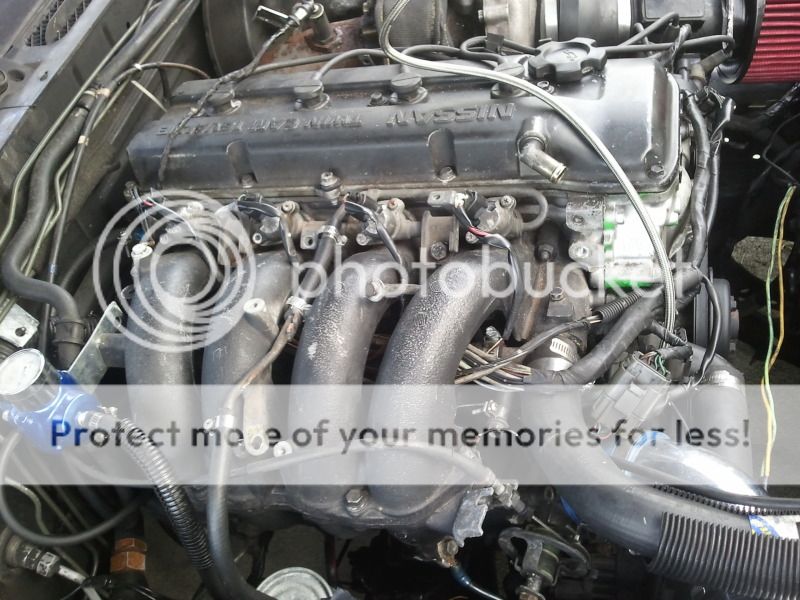

Hi guys me again... Ive gotten this far with all of your help so I decided to make this thread as detailed as possible.
1992 Nissan 240sx
1993 motor and tranny replaced 8 months ago
specs: Ka-T Emance Tuned Ecu, Z32 Maf, stock Purple Sr 370cc Injectors, Walbro Fuel Pump
Garrett t3/t4 Turbo, New NGk #4644 Spark Plugs, greddy bov, Turbonetics evolution wastegate.
The problem is the car when given gas fast it stalls or immediately shuts off. Idles good and when lightly given gas it will run. When I drive it the problem only occurs at stop or in 1st gear, once im moving she runs great. there is no smoke the car does not shake.. the spark plugs are fouling quickly though, all black not wet but I do smell faint gas smell every once in awhile.
(Pictures of everything)
What Ive checked: I checked the BOV for leaks, checked my tps, checks plugs and spark plugs... probably edit this later when I remember all the headaches of things I went through..
any help would be appreciated my last thread the car was smoking up and shaking rough all the help given has gotten me here so I know its gotta be something stupid.. thank you for taking the time to read 561-880-1155 Joe

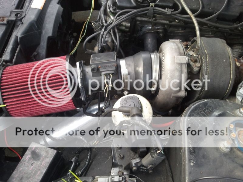

I unplugged the maf and started it but it still shut off instantly when I jabbed the gas (it should run under 3k ok with maf right?)

without the maf it wont drive past 3k and wont drive under any load.. happened to me when my ic pipe blew off. lol

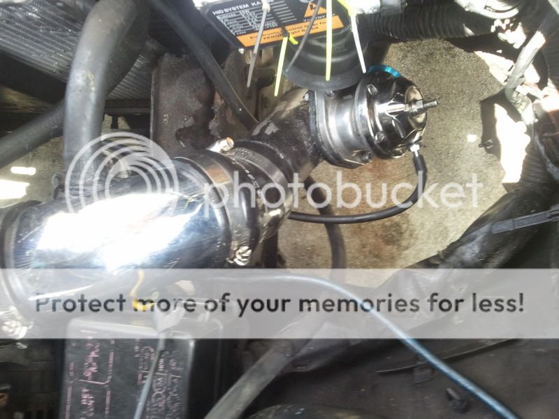

what the setup? vaccum lines removed? capped off? egr sealed? where are you pulling vaccum for the bov and wastegate?

where is your vaccum source for the bov and wastegate?

Where does the vacuum from the wastegate go to
And where does the vacuum from the blowoff valve come from
im uploading the video now the vacuum to the blow off valve is connected to I believe the Iacv hose thats connected to the throttle cold side. also maybe this is my problem the waste gate has two hose nipples on it I have the turbo vacuum nipple connected to the wastegate nipple by hose, the other open nipple on the wastegate is open but doesnt blow or suck

try using one of the vaccum ports on the bottom of the throttle body for the bov.. tha should help and i think you found your problem with the iacv

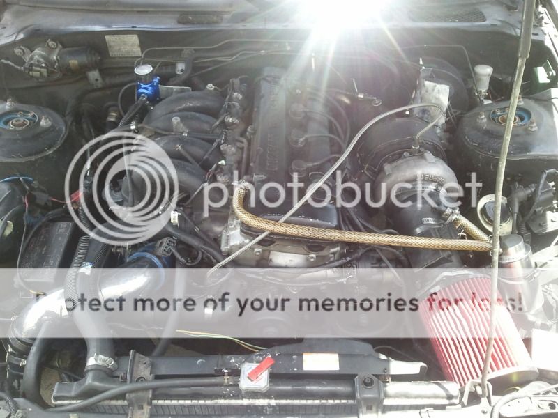

Waste gate has two vacuums ? If so the top goes after boost controller and side goes before the boost controller

Ok then see if you can tee off the brake booster or get a vaccum block.
I dont have a boost controller , springed at 10psi
EDIT: Block off the brake booster hose? tee off as in make a 3 way for hoses to connect?
the vacuum hose on the turbo im assuming needs to be connected to vacuum not the wastegate right?
