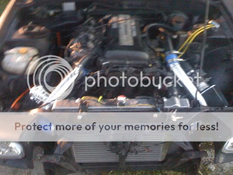

pics of ur setup!!!
This is right after I did it......just like that and it runs cool as fuck.....drifting the temp doesnt past 170
I had the idea that if I did midmount I could do some sheat metal work and make a duct, so the air is forced through the the intercooler and rad. Kinda how v-mount works.
u dont need any ducting......it cools just fine like that
