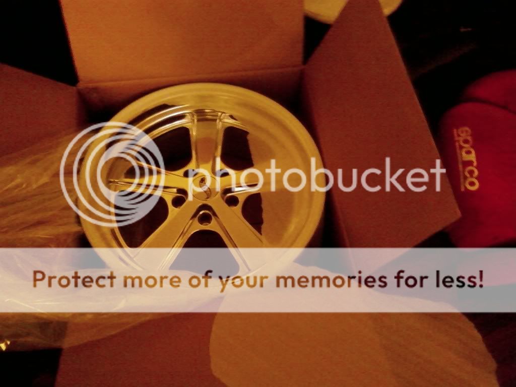

ok well i just took some picture because i never measured the over all diameter of the wheels to check the actual offsets... haha holly shit.
the actual measurement was almost 11.25" with a 10" width, that makes 5/8" flanges and the 5" back space makes the wheel -5/8" offset or about -15mm
for the 15"x8" with 3" backspace and 5/8" flanges that's about -41mm
so yeah that's 15"x8" -41 up front
and 15"x10" -15 out back
