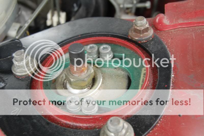

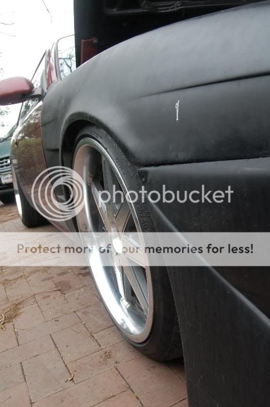

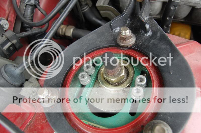

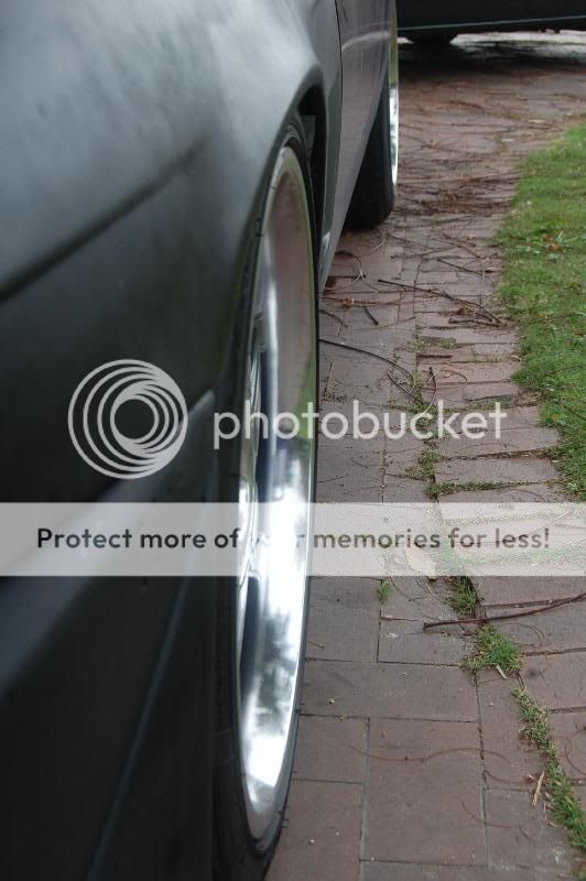

Here are the pics..
Fucked up side thats maxed out:
Other side, still has room to move:
check the lengh of the lower control arm. they might have replaced it with a s13 one which is shorter. if not then either something is bent or your shock tower shifted
could just modify the top of the strut or get adj lca's.
but you should figure out what is bent or wrong...b/c something def is. you are setup for an oval track right now, lol.
just give more your problematic coilovers and get new ones =)
when the ring is bottomed out its acutally close to 3.8 degrees negative, other than that you might have a bent frame or s13 lcas.
How can I confirm I have S13 Lower control arms?
Is there a distinguishable trait they have other than being shorter?
