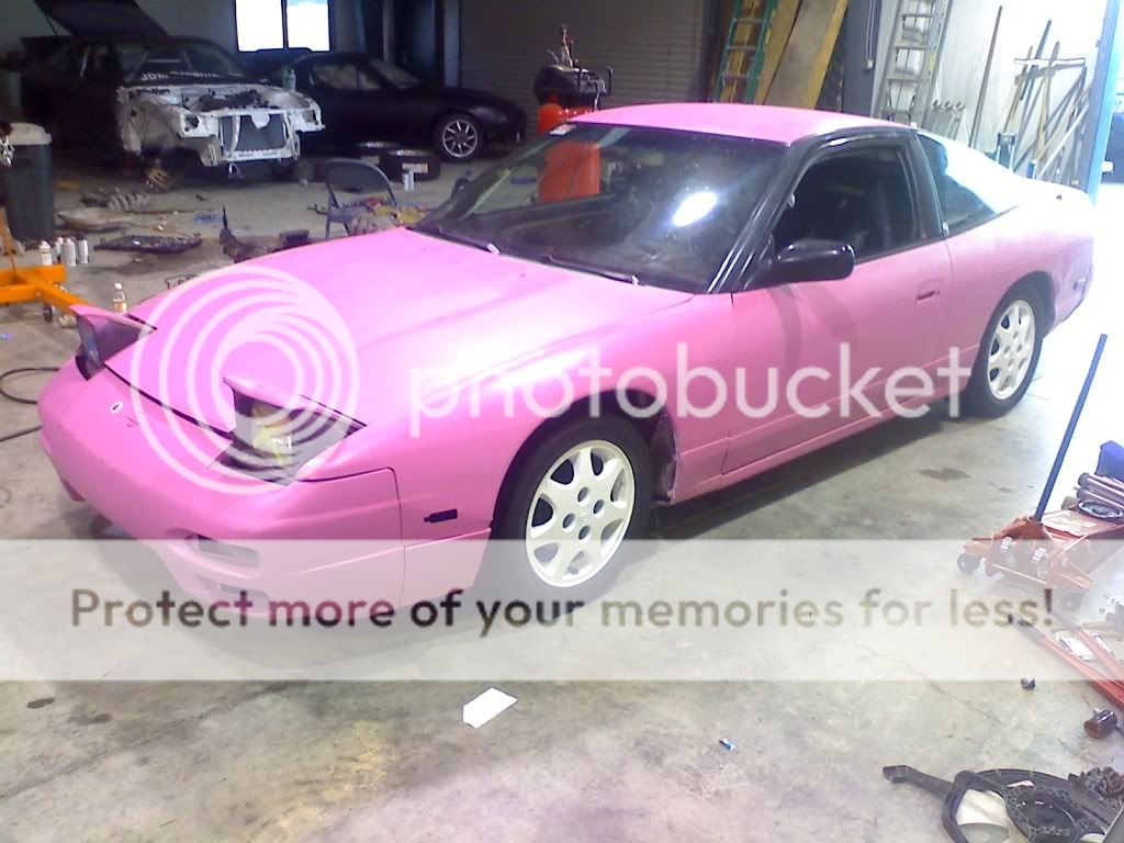

my pink car is high as fuck and i love how it handles. just ksport coilovers and a strut bar.
i have prob a 2 to 3 inch wheel gap
well it doesnt hit shit on the bumpy ass road to the shop and still slides easy as fuh
pepto bismol car has got haters!
